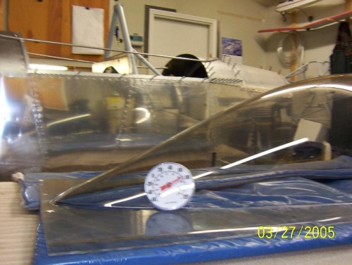

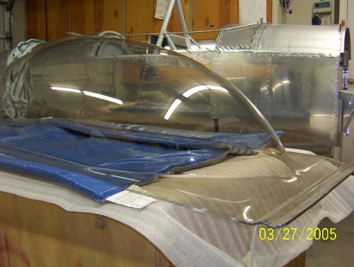

Date:  3-31-2005
Number of Hours:  5.00
Manual Reference:  Sec 9
Brief Description:  Cutting Canopy
Section 9 Installing the Canopy Date 3/31/05 I started to cut the canopy today. I heated the shop to 80 degs. before cutting the canopy. I used a air drill with the fiber disk supplied in the kit . This combination worked very well. After marking the canopy with a sharpie pen from the inside I proceeded to trim the canopy " at a time. After two of sessions I had the fit to the frame. (Image) 100-0157 100-0158 & 100-0159
