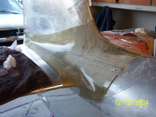

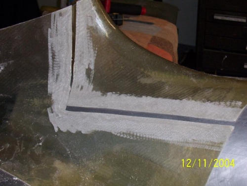

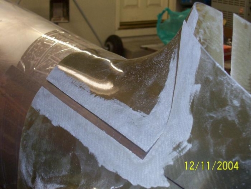

Brief Description:  Empennage Fairing
Section 8 Empennage Fairing Date 12/11/04 I cut the new fairing into two parts and faired the edges in preparation for fiberglass and resin. After I installed the vertical stab. I adjusted the fairing to fit ,drill and cleco in place. I laid fiberglass and polyester resin into the prepared area. After all of this was done I sent the fairing off to Bob at Fairings Etc. Bob performed the final fairing of the re-glassed area. (Image) 100-086 100-087 & 100-093
