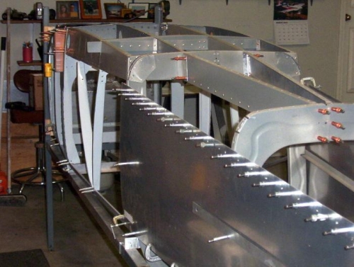

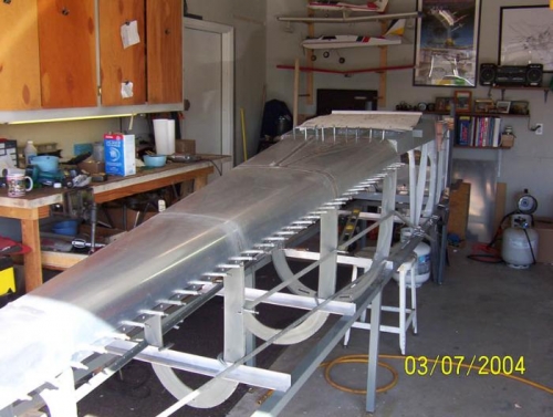

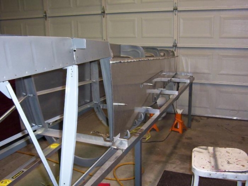

Brief Description:  Building the fuselage frame
Section 8 Fuselage Date 3/1/2004 The builder manual instructs me to start skinning the fuselage with the most aft lower skin F427. I used plastic straps to hold it in place before drilling and clecoing. The next skin F426 uses the same technique of plastic strap and clamps to hold it before drilling and clecoing. The rear side skins are trimmed and installed next. (Image) 160,161&162
