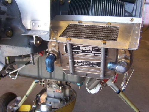

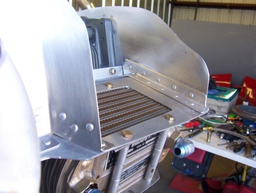

Brief Description:  Oil Cooler
Date 9-1-06 Sec 12I decided to place the oil cooler on the air inlet ramp in front of # 2 cylinder. I replaced the inlet ramp with .060 thick aluminum. I believe this area has sufficient strength to support the oil cooler. The baffle area around #2 cylinder is surrounded by reinforcements, There is an ¾ by ¾ angle that runs along the jug, There are two supports under the ramp on the case side and outer inlet baffle has a ¾ by ¾ angle support. I routed the cooler ports forward and the oil lines are to run under the starter and back under #1&3 cylinders to the accessory case ports. (images) 0443 & 0444
