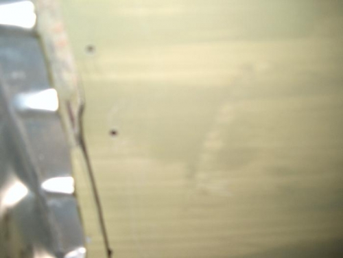

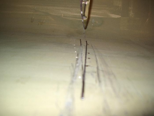

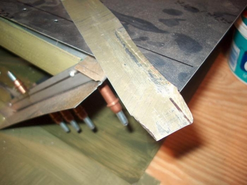

Brief Description:  Remark LE skin for VR8
Remark LE skin to position rivets correctly for VR8 Fuel tank rib. Using a scrib tool (actally piece of scrap AL with a 20 mm wide bend) made light marks in the paint to mark rib on inside of LE. Checked manually. Tool slides across rib cap and scrapes the green just enough to see where the rib is. Ready to continue!
Inside shot with Marking Guide following Rib
New Marks on Rib
New Marks on Rib
Marking Tool.
Marking Tool.
