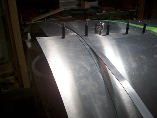

Mark Nose Rib Rivet Lines
Re-Web Nose skin to spar
Drill A5 spar holes
Mark rivet lines for nose ribs using flexible straight edge and pretested rear rivet lines.
Drilled and clecoed to spar
Marked Rivet Lines
