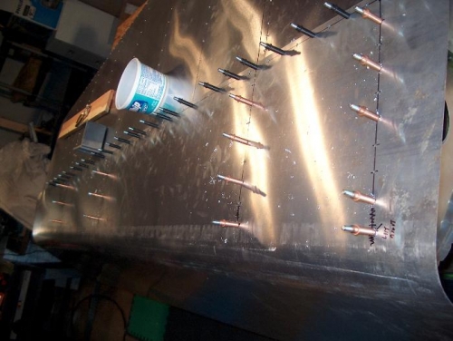

Attach Bottom of Nose Skin To Ribs/Spar
Drill Holes in Bottom Skin and spar line
Punch pilot holes and drill.

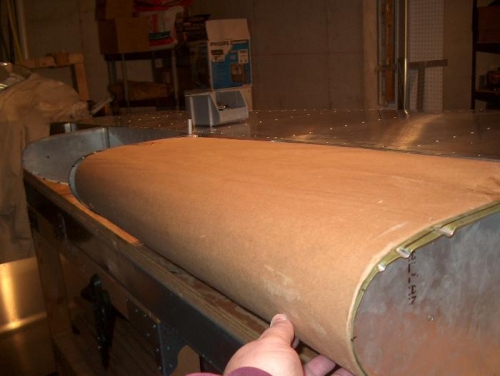

Remove skin to check fit of tank to ribs
Debur spar and skin

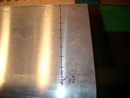

Mark Nose Rib Pilot Holes
- Measure from spar rivet to end of rib
- Mark any crimps
- Mark skin for pilot holes
- Drill Pilot Holes
Reattach skin to spar
Drill Pilot Holes
Attach with A4's at 40pitch
Tank fits right between the ribs
Marked Nose Ribs
Clecoed and ready to go
