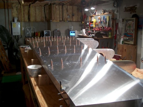

Work on bottom rear skin
Make all L Stiffeners for bottom rear skin
Add L stiffener to replace wing locker
Shape L's to ribs
Prefit skin to ribs
Drill #30 holes in ribs/skin
remove cleco's
Rear skin drilled through ribs
