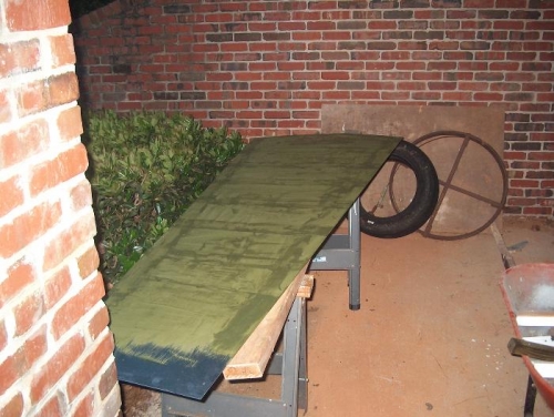

Zinc Oxide, Debur, attach top rear wing skin
Apply Zinc Oxide to bottom of skin and L's
Debur all holes
Cleco, then rivet L's to skin
Cleco skin to the ribs
Fix hand rivter (stuck stem from last use)
Place Tack Rivets on Spar
Zinc Oxide Applied to Skin
