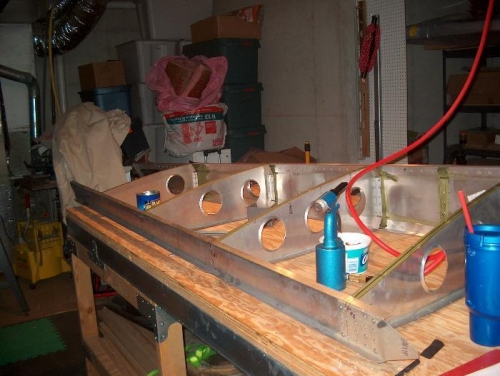

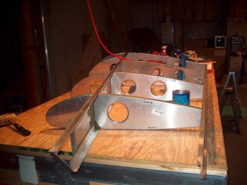

Brief Description:  Build Wing Skeleton
Cleco together skeleton.
Rivet Ribs to Spar with A5 Rivets
Add L8 "L" for Tank
Pilot, drill and rivet L7 "L"
Add 2 AN3-5A bolts to L6 Rib
Attach and drill rear zee to ribs
Detach and debur
Attach plate to Rear Zee with A5 rivets
Attach Rear Z to ribs with A4 rivets

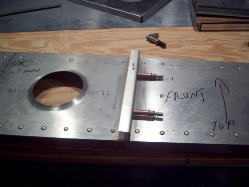

Make L8 a U Channel for Tank
Rear Z attached
Rear Z attached
Rear Z Attached
Rear Z Attached
