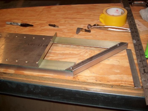

Brief Description:  Drill Rear Z and add L angle to spar
Purchased new #40 bits
Get out Wing Skins
Check Rear Z Against WIng Skins (V-4-3)
Drill pilot holes for ribs
Cut O/B end of 6SV4-2 to 45 degrees
Add L Angle to Spar after Zinc Chromite (V-6-5)
Mark Spar for Ribs V-6-6
45 Degree L added to Spar

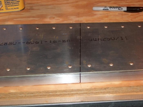

Mark Rivet Lines for Reference
