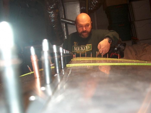

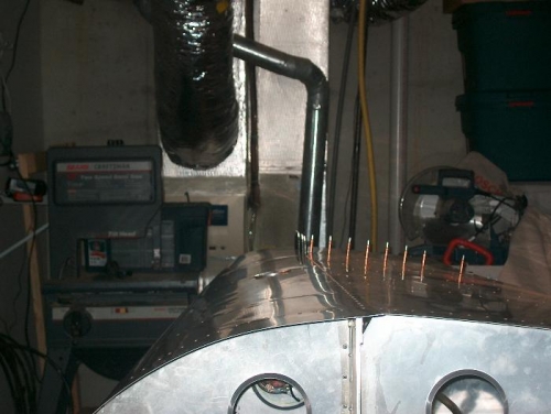

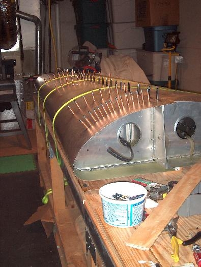

Brief Description:  Close Nose Skin
1. Strap down nose skin using straps, and 1x6
2. Cleco wing skin down to spar and nose ribs.
3. Find the Fuel Cap! I had misplaced it, and was afraid it was in the nose. Found it under the bench.
4. Cleco L6 to rear top skin of wing.
5. Take photos.
6. Using A5 rivets per instructions, rivet nose skin to Spar, proceeding from inner ribs to last outer rib.
7. Attach nose skin to all ribs.
Clamped Clecoed and Ready
Another View
Another View
Rivet Line Getting Done
