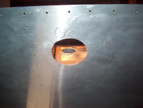

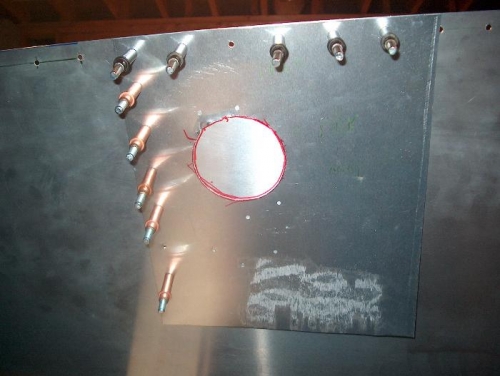

Cut Filler Hole in LE skin
Fit template to LE Skin at NR8 and Spar line Mark skin using hole in template. Remove template and drill starter holes in the skin. Using snips, rough in hole, then slowly work to line. Use Dremel to smooth off rough edges in hole.
Template for Filler Cap
Filler Cap Hole in Skin
