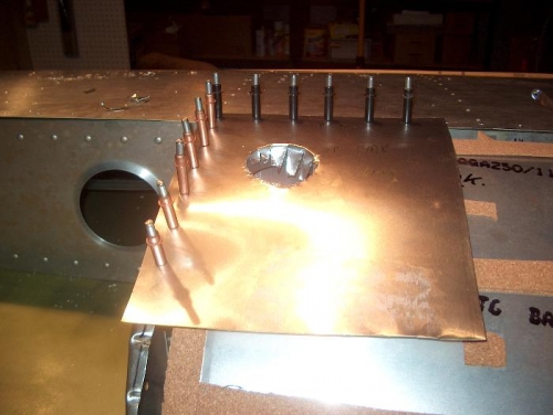

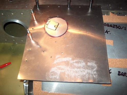

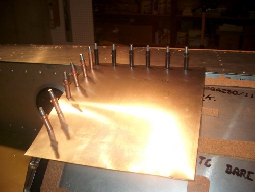

Brief Description:  Make Template for Fuel Inlet
Using flashing aluminum, drill holes through rivet lines on LE skin at spar and NR8 to make template. Cleco template to spar and NR8 using holes as guide. Cut hole to approximate size of fuel inlet using inlet itself as a guide. Dry fit fuel cap through the template.
Template clecoed in place for measurements.
Rough in hole.
Rough in hole.
Dry fit fuel cap through template
