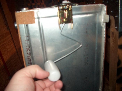

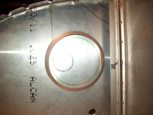

Mark tank through lightening hole Remove tank from wing Dry fit sender to outside of tank to see approximate location internally. Note that empty position is above bottom of tank. Send note to Zenith to verify position before drilling holes.
Mark location through Lightening hole
Photo of empty position
Photo of full position
