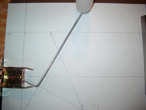

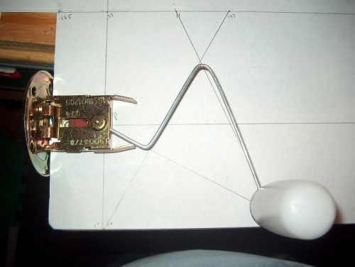

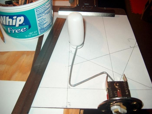

Brief Description:  Bend Sending unit for wing
Using the instructions provided by Zenith, and the guide made per instructions, bend the sender arm to match the geometry necessary for the tank. Then checked the sender with the Multimeter to mark full and empty positions. Right Wing Sender Empty at 69, full at 9 Ohm.
First Bend
First Bend
Bend 2
Bend 2
Check Top
Check Top
