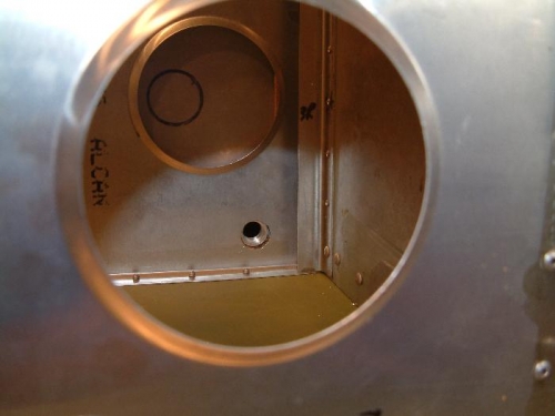

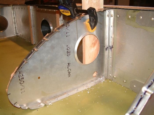

With tank in place, and using previously created template, mark location for fuel outlet in NR7A. After marking, use Unibit and drill board to drill hole in rib. Test fit tank back into hole.
Fuel Outlet Hole Drilled, shows support in place.
Tank back in with fuel outlet all aligned with hole.
