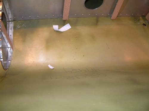

Brief Description:  Drill holes in bottom of wing
1. Use template created to mark locations of holes in skin. 2. Mark center of each hole and use punch to dimple. 3. Make a small pilot hole in center of each hole. 4. Place "Drill boards" underneath wing to support wing and provide clearance for Unibit. 5. Drill both holes in bottom of skin.
