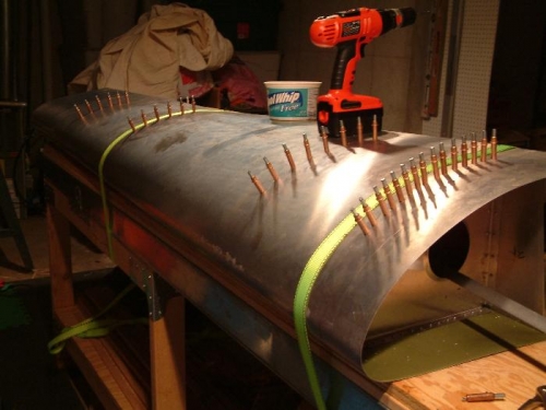

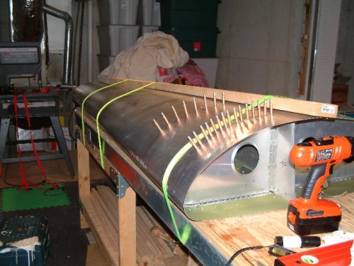

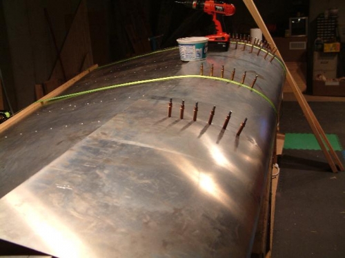

Date:  4-8-2005
Number of Hours:  2.40
Manual Reference:  V-14 Step 22
Brief Description:  Drill and Cleco LE skin to ribs
Reclamp wing to the bench Drill Rib 6SV1-S7A first, cleco Drill Rib #6, cleco and remove clamp Drill Rib #9, using hook to pull in line Drill Rib #8, using hook to pull in line (Thanks Alex for the Assist!)
Drilling Nose Ribs
Drilling Nose Ribs
