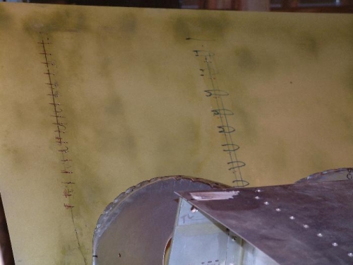

V--14 Step 2
Drill Pilot Holes
Using lines from first bend, mark and drill all pilot holes for the ribs. Used a C-clamp and a 1x4 as a backing when drilling holes from the interior of the skin.
