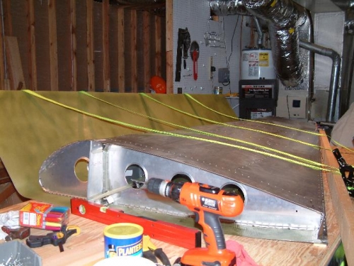

Set up wing per instruction manual Apply Petroleum Jelly to Nose ribs to mark Apply clamps to nose skin, including boards to hold in place Tighten down skin and check Release clamps Mark where PJ marks rib locations
Applied PJ to top of ribs to mark on skin when tightened.
Preparing to tighen down skin to mark.
