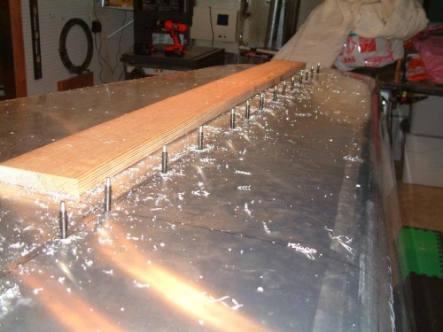

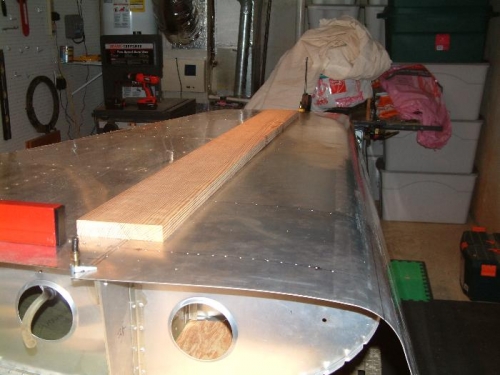

Re-align wing on bench and check all measurements. Check centerline marks on ribs to show through pilot holes. Clamp nose skin to Ribs. Drill and cleco A5 Rivet holes for spar rivet line. Drill and cleco A4 Rivet holes for Nose ribs.
Skin lined up for A5 Spar Rivet Line.

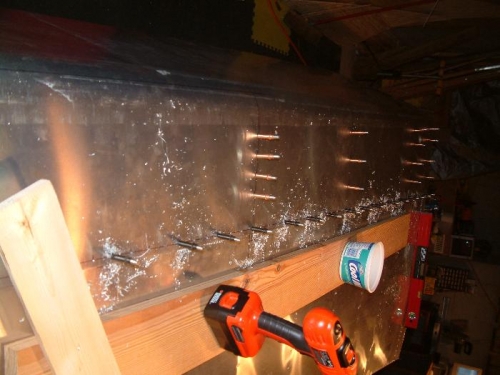

Spar Rivet Line drilled for A5
All Rib positions drilled.
