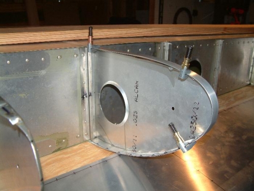

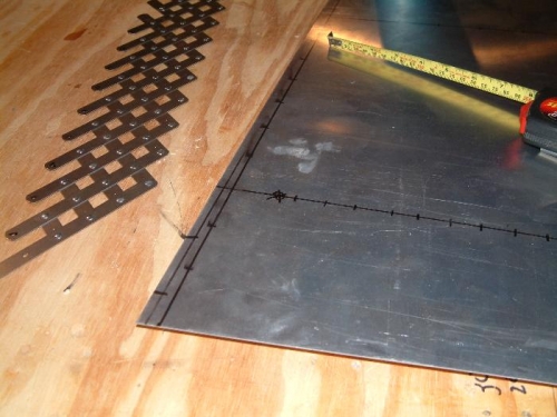

Use band wrapped around each nose rib to mark locations of crimps. Worked well, but remember to clean marks between ribs as each is slightly different. Mark rivet locations for nose ribs.
Marking the Spar Rivet Line
Band around nose rib to mark crimps.
