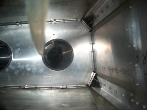

Drill Pilot Holes for Rivets on 20mm side Drill 13/64 holes for #10-24 x 1/2" screws Zinc Chromate all L bits Cut Poly Tube to length Rivet (A4) L's to ribs Bolt on Avdel clamps Attach conduit to clamps and tighten
Conduit and Bracket installed on inboard rib
View down Lightening Holes with Conduit
