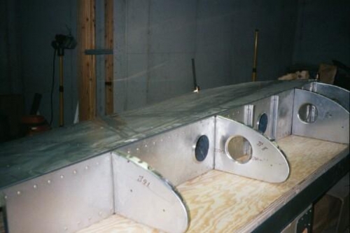

Nose Ribs continued
Replace "bad" A5 rivet on a S6 nose rib that did not seat correctly. Replace Top/Bottom A5 on NR7 and 8 with an A6, per instructions. Install "Extra" L's at 7 and 7.5 for leading edge tanks. Insall AN3-5A bolts to nose rib 6A to 20 inch/lbs.
Nose Ribs attached.
