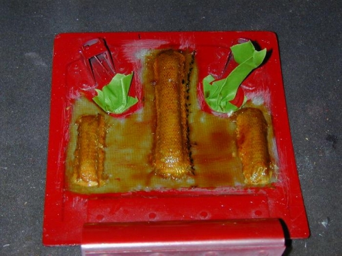

Oil door glassing
Used micro slurry on foam ribs, then applied 1 ply over just the ribs. Then a 2nd ply over the entire modification. This will keep the door from bowing upward from underside air pressure.
1 ply BID glass on foam ribs
1 ply BID glass over area
Door in place on cowl for cure to correct shape.
