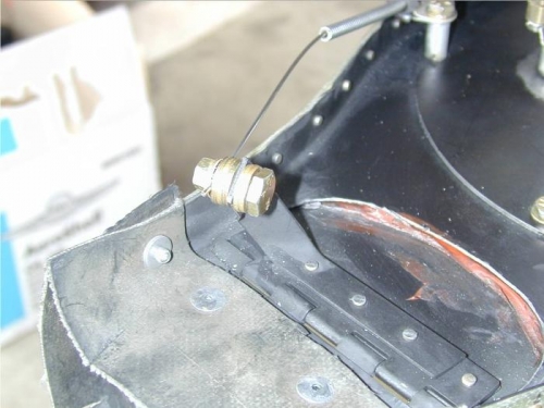

Brief Description:  Alternate Air Door problem
Found the cable attachment for the Alternate Induction Air door, had created a 1/4" dia wear round out in the door swing arm. Repaired by using an AN4-4 bolt and ran the control cable through the bolt hole, pinching the cable with a self locking MS nut.
Alternate air door arm wear after 42 hrs of service.
Repaired.
Repaired.
