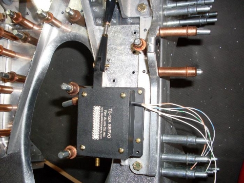

Brief Description:  Fitting of stabilator trim servo

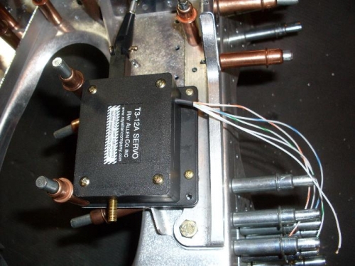

Fitted the stabilator trim servo to the stabilator bulkhead as follows:
1. Drilled another hole in the lower right corner of the servo to correspond to the existing rivet hole in the bulkhead parts. This eliminates the need to drill another hole very close to the weldment and the associated difficulty fitting the nut.

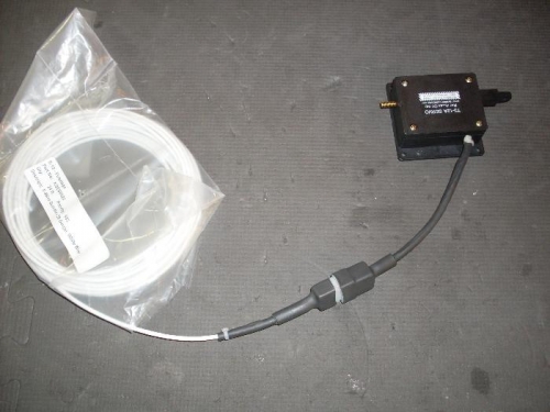

2. Installed a 6-pin molex connector on the servo. Used some spiral wrap to stiffen that up, then small shrink tubing up to the connector, then some 3/4" cement-impregnated shrink tubing to seal it all up. Likewise, I did a short section of one end of the multiconductor wire that will run through the tail cone. A bit of sealer on the shell during final assembly should keep these connections dry.
