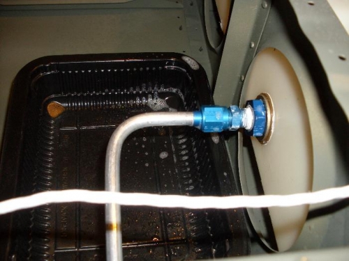

3. Modfifed an extra fuel tank cap with a tire valve to allow air pressure to be introduced into the fuel tank. Capped the fuel vent with a rubber glove finger tie-wrapped into place. Installed a low-pressure (0-3 PSI) air gauge on the tank output.
4. Pressurized tank to just over 1.0 PSI and sprayed fittings with a soap/water mixture. Tightened tank outlet fitting to obtain a better seal.
Pressure testing is OK. Wing is ready for top and leading edge skins.

The plastic tray catches the soapy water
