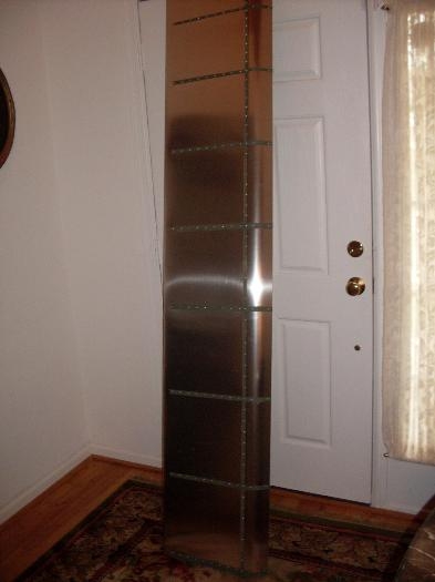

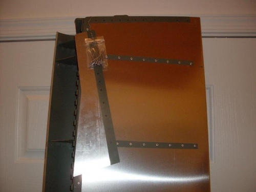

RH flap - final assembly
Completed assembly of the RH flap as follows:
1. Removed skin from frame, deburred, prepped and primed.
2. Reassembled flap with cleco's. Riveted to Rans rivet schedule.
3. Omitted rivets from fuselage fairing - will complete during final assembly.
RH flap headed out the door

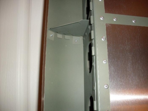

Super fit on leading edge ribs
Fuselage fairing will be fitted during final assembly
