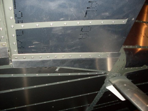

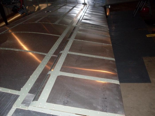

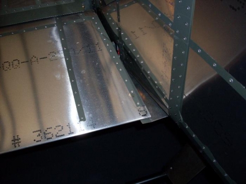

Completed flap rigging as follows:
1. Adjusted and connected flap linkages. Secured lower bearing with AN4 hardware.
2. Riveted lower flap fillets in place.
3. Checked flaps for freedom of movement and positive detents.
