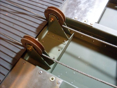

2. Prepped, primed, and riveted forward rudder pulley assembly. Passed rudder cables through and attached pullies using provided hardware.
3. Attached rudder cable fair leads to fuselage center section.

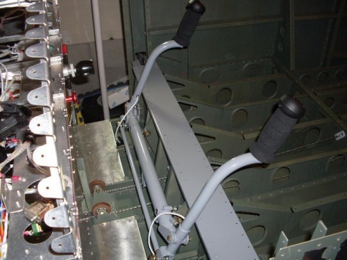

5. Attached control stick assembly using AN4 hardware provided. Left nuts loose for now.

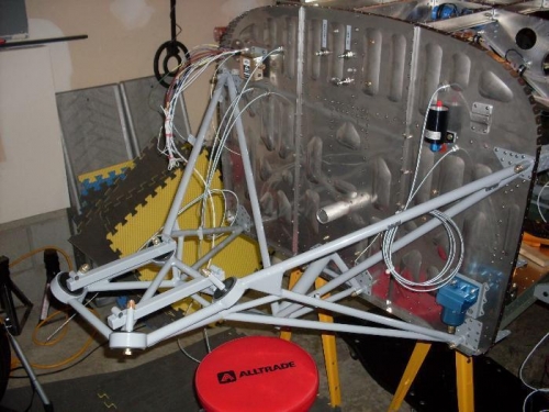

7. Attached nose gear mount and engine mount using AN5 hardware. Torqued nuts to spec.
