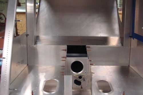

So with all that said, I cut two holes in the baggage compartment floor for access panels...will have to fabricate the covers. Then I riveted pretty much everything else on the rear fuse except the front lower gussets and also the where the seat belt brackets attach and where I would add a doubler for the banana slot mod...all in case I change my mind!!

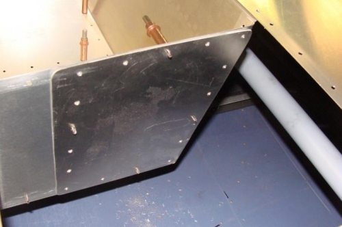

Additionally I fabricated two doublers out of .063 aluminum, that wil be riveted to the sides of the tunnel, in the area where the elevator attaches...and I left both of the tunnel side pieces unriveted in case they need to come out to complete the divorce mod.

Tunnel sides unriveted
.063 doublers
.063 doublers

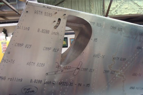

Note no rivet areas..don't go by the written stuff
