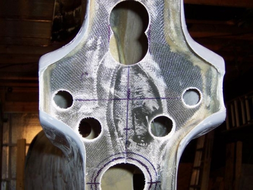

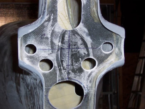

Brief Description:  Res., drill, enlarge, dress cable & access holes i
Made large bottom access hole 3.25" vs 3.125" to fit my large hand!
Largest hole saw I had was 2.5", so drilled it then used die grinder to open up to 3.25"
Top hole...elevator push rod
Two 1" outside holes .... nut access for HS spar bolts
Two 1 1/4" holes.... rudder cable through holes
Bottom 3.25"..... access holes for nuts/bolts etc.
raw holes drilled
raw holes drilled
enlarged top and bottom holes

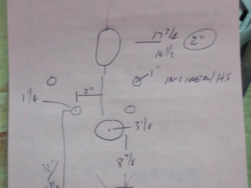

measurements
measurements
