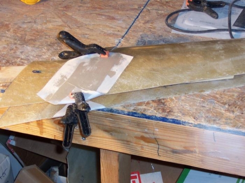

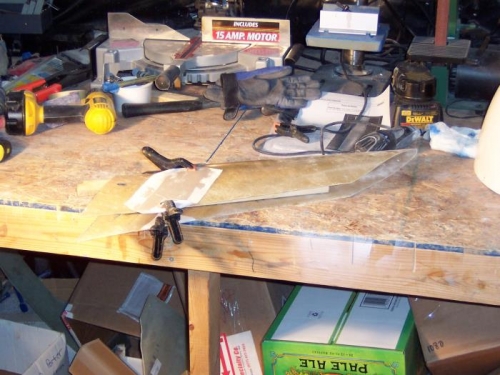

fit, cut repair nose fairing
cut off too much from top of fairing. Would have been OK as it is hidden by bottom cowl. But, decided to re-attach top piece on for a better fit. 2 BID to joint - stiff, good
