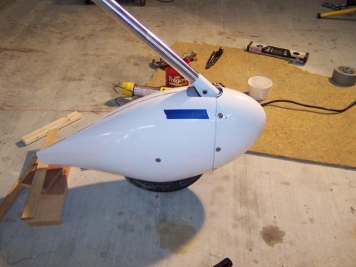

nose pant on
1 mis-aligned nutplate at blue tape....will tackle that in next session. Fit fine loose on the bench
.125x1.5" AL bar stock. Missing from kit - bought at Lowes
Lots of fit and trim for nose pant, nose pant brackets, etc.
Manual sucks.... bad measurements and correct parts/raw material NOT provided.
lots of engineering time last 3 days.

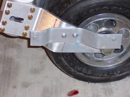

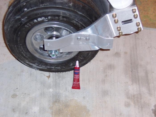

Red loctite 271 on bracket to fork, 10-32x3/4" SS truss screws
tap to 10-32, screws on w red loctite
8-32 rivnuts for pant to bracket
pant on
