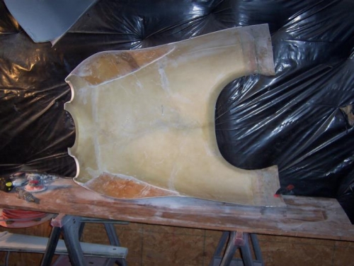

Brief Description:  trim inside of cowlings

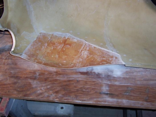

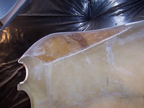

cut away excess FG from inside of both cowl halves...the extra original cowling that was under the blisters. Grind back to flow. Will add a radius of micro.
Sand/grind/prep area on lower cowl that will receive 6 BID to create new flange.
Cut BIDS for flange...will layup next weekend. I think 6 BID will be enough; can add more later if needed
