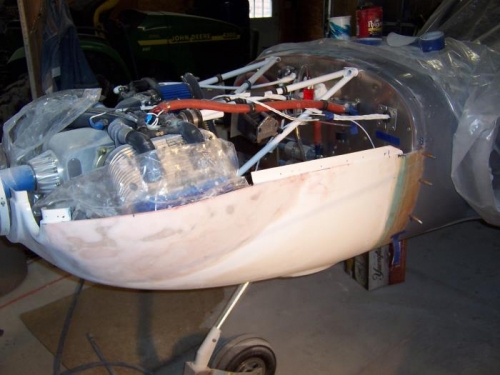

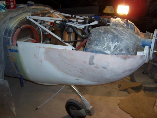

Brief Description:  cut top and bottom cowlings apart
Going with 8 fasteners across cowling flange
With extending cowl length for UL engine I needed to add some fasteners. Set aft and forward screw locations visually. 43" between those 2 points. Spaced 6 add'l hole locations in between... about 6 1/6" apart.
Will trim some of the remaining excess from original cowling once I get the whole thinig on a table. And add a flange to bottom part...for receptacles
snapped chalk line; cut with dremel w diamond blade
will need to add flange to bottom

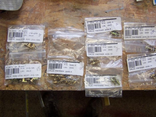

1/4 turn fasterners; will need add'l
