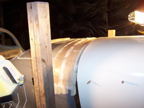

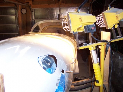

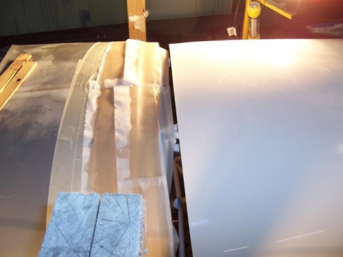

4 BID layup for cowl extension - top
Did top only. 4 BID 5.5" by 46". Masking tape then release packing tape on fuselage then layup to that. Peel ply on top. 26 pumps of epoxy
From joggle to 4" behind cowl seam at FW.
Will bond the "new joggle" to underside of cowl and add 2-3 BID from the underside. May add 1 BID to top across the seam is needed.
