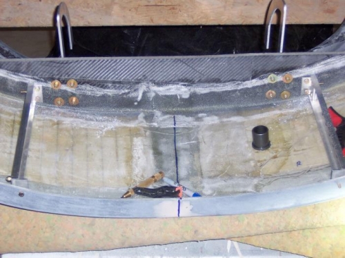

fabricate rudder pedal brackets
need to get a good 1.25" metal hole saw to drill holes in both brackets for bushings. The saws I had went no where.... will get a good one from ACS
match drill into engine mount flange and fuselage flange; 1/2" lightening holes
rails 12" off of center line and as far "up" as they could go

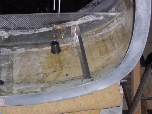

right side
nuts not tightened down yet

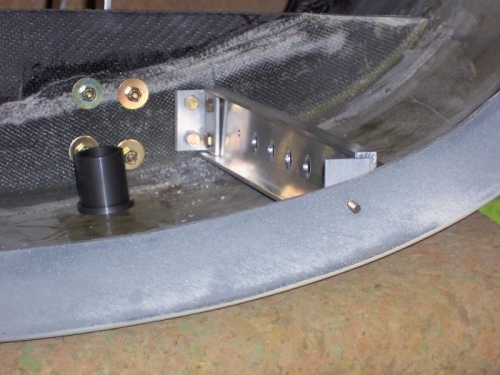

both sides in
