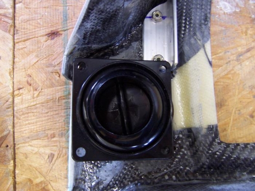

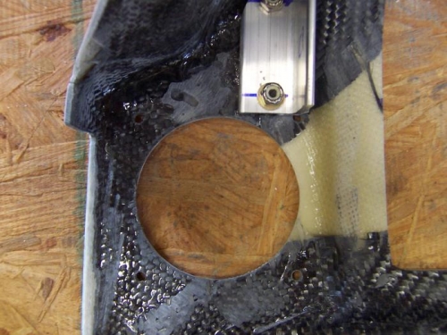

vent hole not in right position
should be 3.5" from BOTTOM of panel cut-outs. I had used the inside cut-out
Vents will not fit in with canopy strut bracket, as is.
