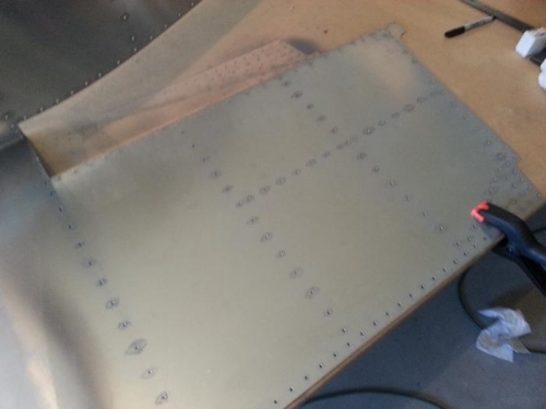

Brief Description:  Deburred, Removed Oxidation from Skin
Removed the oxidation from around the pre-drilled holes in the left aft stabilator skin. I used a "Mouse" type sander with 220 paper. This process is very time consuming. Oxidation appears on all holes and on both sides of the skin. Also the edges of the skin have oxidation. Sanded so that oxidation was not visible. Then used a ScotchBrite pad on the Mouse sander to remove the orbital sander swirls. Washed with Dawn detergent and a ScotchBrite pad.
Oxidation Around Pre-Drilled Holes
