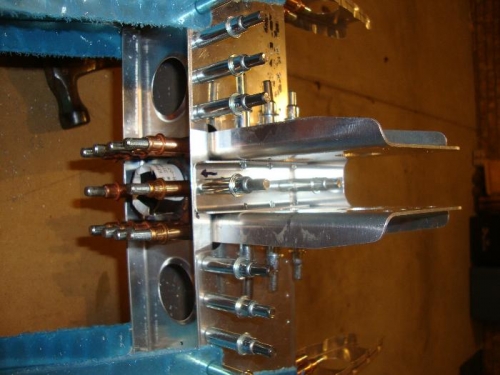

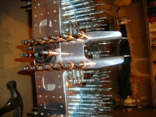

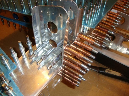

Drilled and Clecoed Stabilator Horns
Finished clecoing the stabilator horns. Transferred and drilled #40 the stabilator plates to the actuator horns. Transfer drilled and clecoed the stabilator channel between the actuator horns.
Stabilator Horn--View 1
Stabilator Horn--View 2
Stabilator Horn--View 3
