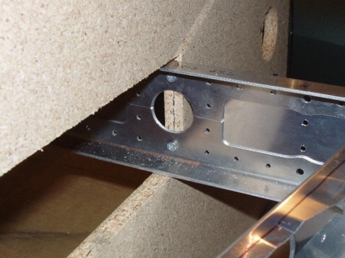

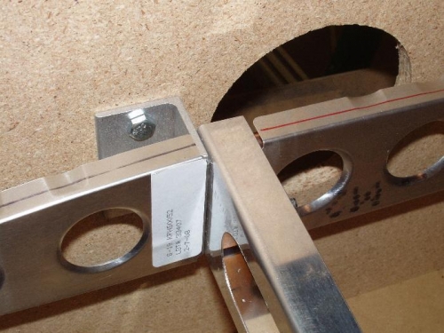

Brief Description:  Fastened Front Spar to Jig
Fastened the main (front) spar to the jig. At the center of the jig, I used #8 self-tapping screws. Each end of the main spar is attached to jig angle bracket using #30 clecoes. Note that bracket goes between the spar and the front rib. The angle bracket is fastened to the jig using 1/4-20 x 1" bolts.
