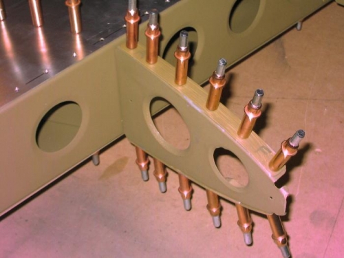

I was not pleased with the way that the forward skin layed down over forward rib #5. So I added shims to both sides of this rib.

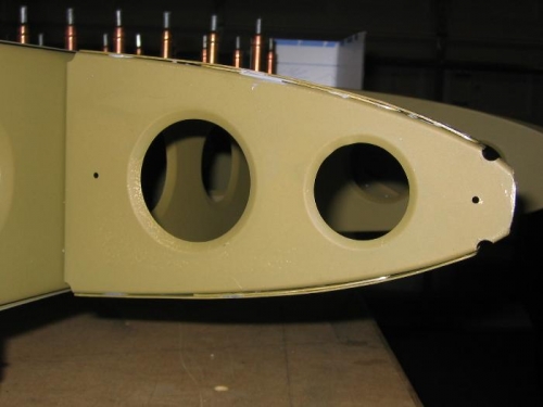

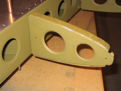

Fabricated shims from raw aluminum sheet and drilled them to align with the holes already drilled in the ribs. Used a 2-part epoxy adhesive to hold the shims in place.
Re-fitted forward skin to the forward ribs and verified that the foward skin fit much better after addition of the shims.
Shims Clecoed In Place
Shims After Epoxy Dried (1)
Shims After Epoxy Dried (2)
