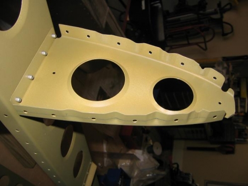

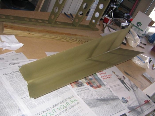

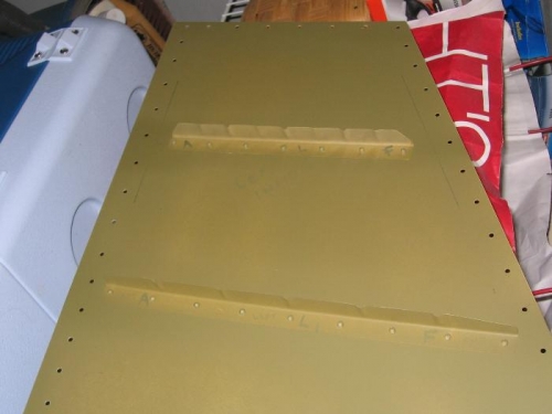

Brief Description:  Riveted VS Skins to VS Frame
After VS skins (left side, right side, and forward) were drilled #30 and clecoed, I disassembled and deburred all holes.
Primed the interior surfaces of the skins and primed the ribs where I had smoothed the sharp edges. Dusted the entire VS frame with another light coat of primer.
