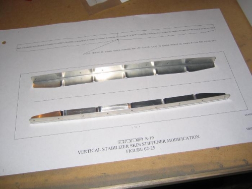

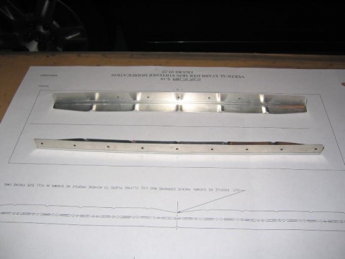

VS Skin Stiffeners--Fluting
Used fluting pliers to fabricate skin stiffeners so that they conformed to the 1:1 profile shown in Figure 02-25. Photos show that resulting shape matches Figure 02-25.
Fluted Left Skin Stiffener
Fluted Right Skin Stiffener
