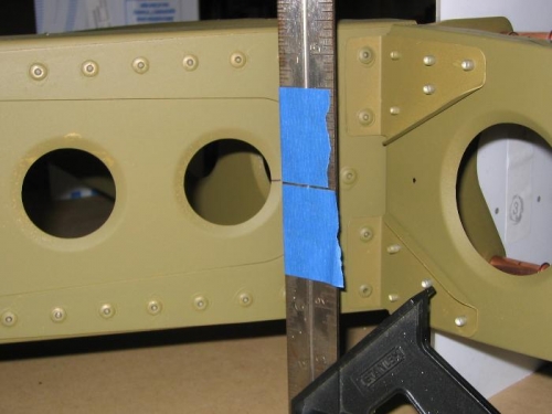

Verify VS Frame is Flat With Table
Measured from work surface to center of vertical stabilizer front spar, rear spar and ribs. The purpose is to verify that the vertical stabilizer frame is flat (parallel) to the work surface.
Measure from Table to Spar Center
