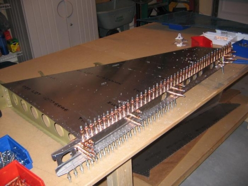

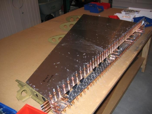

Clecoed side skins to the rear spar and transfer drilled to #30.
Labeled the side skins and removed them for later installation.
LH Side Skin
RH Side Skin
