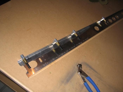

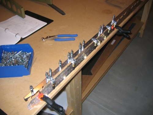

Clamped the rear spar reinforcing angles into the rear spar as shown in the parts drawing on page 02-01 of the Parts Manual. Verified that the parts fit together with no gaps and that the angle of the spar edge was 85 degrees. Transfer drilled #40 and clecoed the reinforcing angles into the rear spar.
Clecoed the rear spar plate reinforcement to the rear spar. Transfer drilled these to #30.
Clecoed the rear spar plate to the rear spar. Transfer drilled these to #30.

Clamping LH Reinforcing Angle
Transfer Drilling LH Reinforcing Angle
